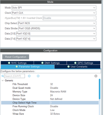

当我通过 stm32 的 OSPI 使用 OctalRAM(IS66WVO16M8DBLL) 时,我只能读取 ID rigister 和 CFG rigister,但不能写入 CFG rigister。我希望你能给我一些技术帮助。
我附上了密钥代码。

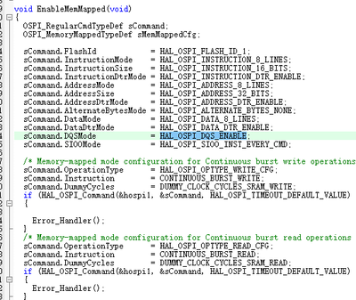

Which STM32U5 are you using?
If you using STM32U575, please make sure that the DQS is enabled in memory mapped write because if the DQSE control bit of the OCTOSPI_WCCR register is cleared for memories without DQS pin, it results in an error response for every memory-mapped write request. The workaround is when doing memory-mapped writes, set the DQSE bit of the OCTOSPI_WCCR register, even for memories that have no DQS pin. For more information about this errata please take a look to the errata sheet and precisely section 2.6 OCTOSPI
For that please enable the DQS mode when configuring the command for the write instruction:
sCommand.DQSMode = HAL_OSPI_DQS_ENABLE;
I hope this help you!

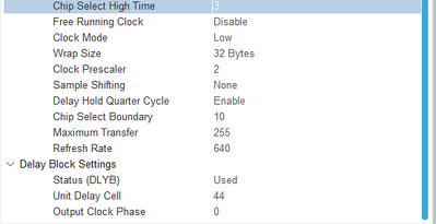

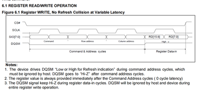

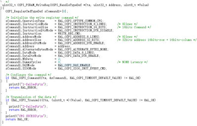

Thanks for your help, I have opened the DQS mode, but I have encountered a problem, as shown in the figure, the first two bytes (or some two bytes) cannot be written normally, I think it is because my psram chip is not set to DQS mode, but now my register can only be read but not written. But my register writing code was strictly in accordance with the psram manual, and it was the inability to write to the register that now caused me to accidentally get a two-byte error in memory mapped mode.So basically my question now is, why is my register write code not writing successfully.
DQS mode is opened:
write rigister code and The timing chart in the manual:

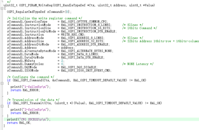

2024-01-22 1:03 AM
The above diagram has an error, using this code, but it still cannot be written properly.
write rigister code:
2024-01-23 5:30 AM
