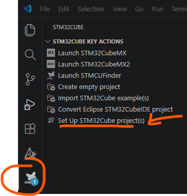

Not sure about, your report is opening many doors possibly - let's be more accurate if possible -, may you lack about project setup step ?
Have a try to call it back explicitly:

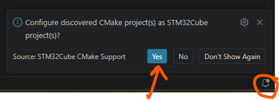

I'm saying "back" because adding some supported (Cmake project for now) material to VS Code workspace you may had got the following notification:

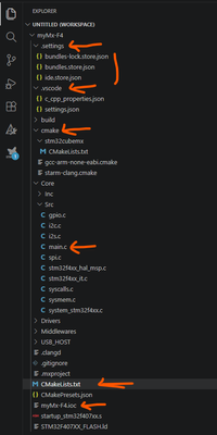

Is your project looks like ? Right after workspace addition and project setup.
Debug and so launch.json being next step.
