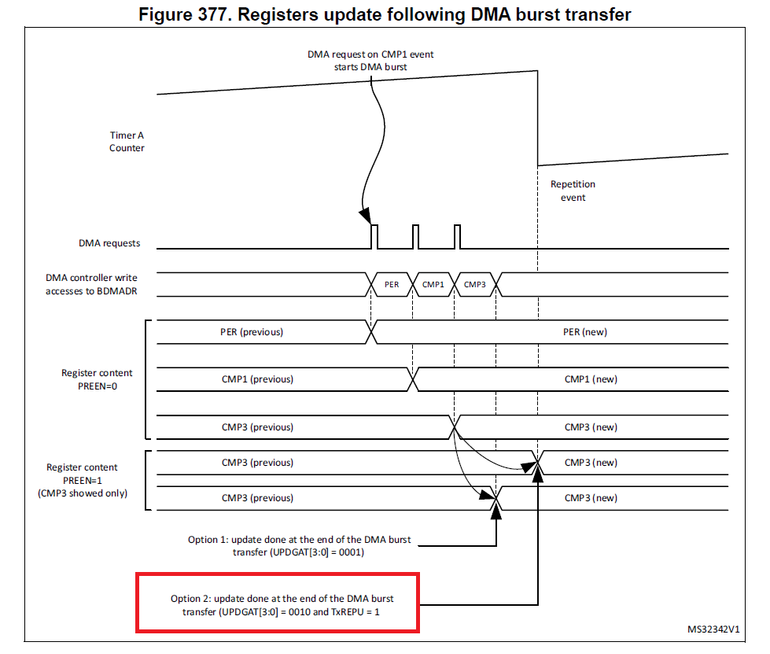

Hallo there,
I use HRTIM_MASTER to retrigger HRTIM A,B;C and to trigger ADC. This works fine.
Each of slave timers generate PWM signals. I works also good.
As the data from ADC is ready I do recalculation of PWM duty for all 3 channels. And there is an issue.
Shadow registry and update on counter reset (bit TxRSTU) should be executed only if all three values are ready. Sometimes I get faulty PWM because third PWM value is not recalculated but gets updated together with first already calculated duty for A and B.
How can I implement double condition of shadow update: once as all 3 dury are new calculated and on counter reload (to keep PWM cycle consistency).

A : According to RM0399, and regarding your application, I advise you to perform Burst DMA transfers (explanation chapter 39.3.21) with the coherent update below. The principle is to reprogram dynamically which CMPx registers are to be written by DMA.
 When the preload is enabled (PREEN bit set), there are 3 use cases:
  • I think, the one that interest you is this one : "The update is done on the update event following the DMA burst transfer completion (UPDGAT[3:0] = 0010 in HRTIM_TIMxCR and BRSTDMA[1:0] = 10 in HRTIM_MCR). This mode guarantees both a coherent update of all transferred data and the synchronization with regular update events, with the timer counter. In this case, if a regular update request occurs while the transfer is on-going, it will be discarded and the effective update will happen on the next coming update request."

Hello Pierre,
it sounds good for me. I'm just trying to impement it with HAL library. Not an easy task. Is there maybe example code based on HAL functions?
