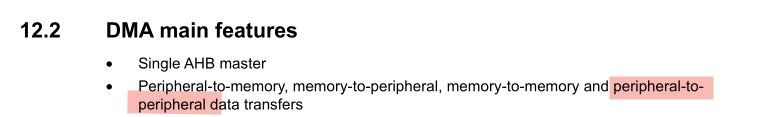

Of course you can DMA data to a peripheral address range.
according to RM, even directly  from peripheral to peripheral. So what's the problem?

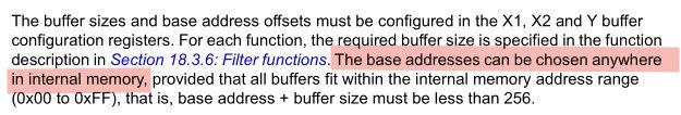

But you can split up the internal memory as you wish. You can remap the base address (relative offset *within* internal memory) before you start up the FMAC, and you change the size of the buffers you want FMAC to work on. I think this could totally work, but I have no experience that proves it.

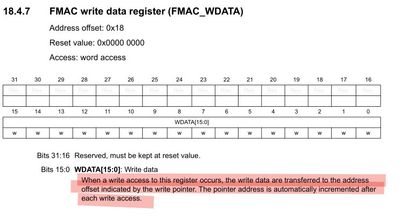

So you already know about the WDATA register. At this point, I'm not quite sure what you're asking about.
Access to internal memory is through these WDATA/RDATA registers and an internal auto-incremented pointer. You can absolutely DMA to that peripheral register.

I'm pretty sure when FMAC is doing its "pull" thing via DMA, it is simply triggering a DMA request which ultimately results in a write to WDATA taking place over the bus. There is nothing magical going on.
> It seems a DMA request from the FMAC or a write to WDATA is the only way to get info into the FMAC internal memory.
Fine, and wouldn't a DMA write to WDATA triggered by the producer peripheral work?
