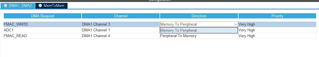

I'm trying to send data from ADC to FMAC directly via DMA in circular mode. From the STM32G4 reference manual (dm00355726) page 402:
"Peripheral-to-memory, memory-to-peripheral, memory-to-memory and peripheral-to-peripheral data transfers"
But I can't find anything on STM32CubeG4 that configures that. Here's a screenshot:
I've tried writing to FMAC write data register directly using
HAL_ADC_Start_DMA(&hadc1, &FMAC->WDATA, 1)
But it doesn't work.
What worked for me was setting the DMA circular mode for both ADC and FMAC, then syncronize it using DMAMUX requests. Although this eliminates the CPU in the process, it doesn't feel like a true peripheral-to-peripheral transaction.
How can I make a DMA transfer content from one peripheral to another, directly?

Read out and post the content of DMA/DMAMUX and if needed, other peripheral registers content.
Helder Sales
December 7, 2020
My apologies. I've read the DMA contents.
DMA1 registers was as follows:
ISR 0x7
CCR1 0x35AF
CCR4 0x36AF
CNDTR1 0x1
CPAR1 0x50000040
CPAR4 0x4002141C
CMAR1 0x3CD
CMAR4 0x200002A0
I think based on CMAR1 that I've provided the wrong address (0x3CD, should be 0x40021418 from what I've seen in the debugger), so I did that:

Too bad peripheral-to-peripheral is "unusual". It should be usual IMO, because this could save resources and time.
Edit: I'm not sure if I'm violating any rules trying to write directly on the FMAC Write data register, because it seems from the Ref. Manual that is r/w.

> Okay, and what are the symptoms, now?
It triggers the ADC_DMAError() (transfer error) callback.

I've tested with UART, and it works!
Configured ADC in 8 bit mode and slow output rate, USART2 without interrupt or DMA, and then
HAL_ADC_Start_DMA(&hadc1, &USART2->TDR, 1);
The serial comm printed the ASCII equivalent of whatever the ADC was reading (I've tested varying a DC signal on the ADC input).
So, the problem most probably is with the FMAC peripheral, because when I try to put anything into the WDATA register, it gives me a transfer error. And I can't see anything wrong, the SR just tell me that the output buffer is empty (Y_EMPTY is 1) and the rest is 0.

Ok, now I've got everything working now. The Half Word data width in ADC DMA configuration was the problem. Once I set up as Word, everything started to work.
Not sure why this gave me problems, the UART did work just fine with the ADC as Half Word (actually I thought it should be byte). The FMAC on the other hand, refuses everything except Word.

The APB peripherals registers are accessible through Word access (32-bit). If there is 16-bit or 8-bit access then this access is transferred into 32-bit access. As written in RM0440 (Chapter 2.1.5 Bus Matrix):
Note: When a 16- or 8-bit access is performed on an APB register, the access is transformed into a 32-bit access: the bridge duplicates the 16- or 8-bit data to feed the 32-bit vector.
This is probably reason why the USART worked also with half-word access (USART1 is on APB2 bus).
The AHB peripherals register access is defined for each peripheral in registers description (RCC, Flash interface registers, CRC, DMA, DMAMUX, CORDIC, DAC, RNG, GPIO). For the FMAC (which is also on AHB bus) is there no definition written in RM0440. I think that access is usually 32-bit only (if nothing else is written in RM0440).
We will try to improve this description in future documentation.

Recently I noticed that the Reference Manual (RM0440) has been updated. Section 18.4.7 states:
FMAC write data register (FMAC_WDATA)
Address offset: 0x18
Reset value: 0x0000 0000
Access: word and half-word access
But the FMAC does not function properly when you use DMA with half-word destination (or even using a pointer to write directly in code). I think either the documentation is wrong, or I'm missing something to make the DMA transfer a half-word (or writing via pointer) into that WDATA register.

You are right - those register can be accesses only by 32-bit. This is mistake in RM0440 (for WDATA and RDATA registers). All FMAC registers should have only word access. We will modify description of WDATA and RDATA FMAC register: "Access: word access".
I have tested the behavior (DMA and direct CPU write to WDATA register) and tests confirmed that 16-bit access is not working (only 32-bit access is correct).
