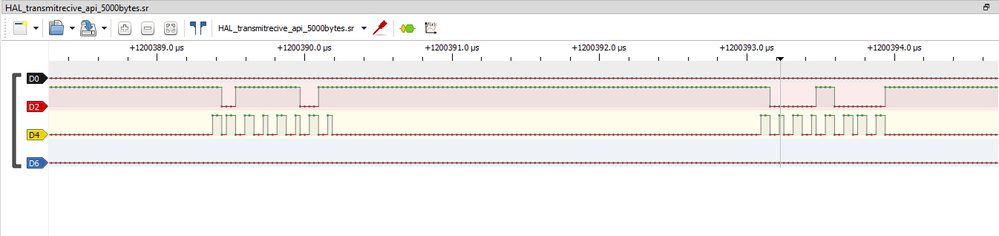

Logic analyzer observations
I then captured the SPI signals using a logic analyzer (PulseView .sr file attached can be opened in pulseview software).
Key observations:
  • The SCK is not continuous
  • The clock appears to be generated byte-by-byte
  • There is a noticeable gap between successive bytes, almost 2.9 us.
  • It looks like software is triggering the clock rather than the SPI peripheral running continuously (Please correct me if my interpretation is wrong.)

Yes, this is a well-known "feature".
@Zaeem-Ahmed wrote:
  1. Why is the official STM32 HAL SPI API unable to keep the clock running continuously at the configured 9 MHz? otherwise why would it offer 9Mhz?
The HAL source is available for you to inspect.
You will see that HAL_SPI_TransmitReceive() does quite a lot of work between the end of one byte* and the start of the next.
 You can improve matters by increasing the compiler optimisation level.
For maximum throughput, consider using DMA.
* Or whatever size transfer you are doing
@Zaeem-Ahmed wrote:
2. Is SPI clock generation strictly tied to writes to SPI->DR?.
Yes.
This is fundamental to the operation of SPI; not specific to STM32: there is exactly one clock per bit transmitted.
If no bit is transmitted, there is no clock.
Yes.

> 1. Is SPI clock generation strictly tied to writes to SPI->DR?
Yes. SCLK is directly tied to an ongoing transmission.
> 3. Is there any way (using HAL) to keep SCK running continuously while receiving data?
Find out what the HAL code does in between the transmissions.
As mentioned, the code is available for inspection.

No - the delay you describe is down to the HAL software overhead.
