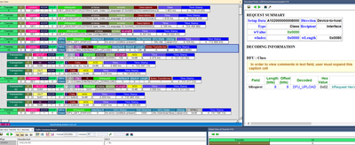

Hi @Strongato
Would you provide working project over STM32G0? Can you provide more details about your device.
Unfortunately, we don't have an example DFU host.
I couldn't reproduce the issue you mention, it doesn't get stuck in USB_WritePacket as you mention. On my end, I used an H7 as device, and here is the trace using 128B for DFU_UPLOAD.
To give better visibility on the answered topics, please click on "Best answer" on the reply which solved your issue or answered your question.Best regards,FBL
StrongatoAuthor
Jan 26, 2026 9:55 AM UTC
Hi FBL,
Thank you so much for your reply!
I've put the G0 project onto the github page as well, but as you will see, the USB DFU HOST class is identical.
I just created a new project, configured USB HOST and added my class.
I'm unsure why you sent a DFU_UPLOAD request, I don't even have that implemented in my USB DFU HOST code?
The infinite loop happens when we are sending a DFU_DNLOAD with wLength > 128,
but from your screenshot I see you sent 1 byte. Could you try sending 192 or higher if you're using my code?
Could you provide more information how you are testing this, so I could get a better understanding how I could help?
Are you using the Teledyne LeCroy to send DFU packets or you wrote your own USB DFU HOST example code?
I do not have access to a USB protocol analyzer, so I cannot provide a screenshot.
We only own a SALEAE logic analyzer, but I'm not sure how helpful the output of that would be.
DNLOAD request with wLength:
[0, 128] - works
<128, 384] - infinite loop between CTRL_DATA_OUT and CTRL_DATA_OUT_WAIT
<384, inf> - stuck at CTRL_DATA_OUT
It gets stuck after 384, because the value of tx fifo size is 384
(I did not change this, so it's probably default).
