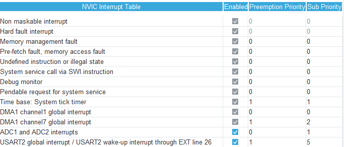

I kept testing and saw that whenever the ADC error happens, the hadc1 handler has an error code = 2. Which results from the call to HAL_ADC_ErrorCallback(). However
I see that the error is set to 2 after an overrun error.
/* Set ADC error code to ADC IP internal error */
SET_BIT(hadc->ErrorCode, HAL_ADC_ERROR_OVR);
I dont know what might be causing this overrun. I found some an old post (https://community.st.com/s/question/0D50X00009XkaVr/f2xx-what-can-cause-an-adc-overrun) of a user describing the ADC usage with the same configuration as me (multimode, triggered by a timer and handling the data with the DMA) with this same error, but he did not post any solution. In another post he posted an article in his website (https://blog.frankvh.com/2012/01/13/stm32f2xx-stm32f4xx-dma-maximum-transactions/) where he interacted with ST support and concluded that the simultaneous use of more than 2 DMA channels was giving trouble... and I'm using 3 (ADC, UART TX, UART RX).
Then my question, is 8 years later than those posts, is there any extra information on the topic or should I just try to use DMA only twice?

I'm sampling at 20kHz with timer trigger. My device is the stm32f334r8 and I don't think I have the fifo feature in the DMA so i will say no. I understand that the overrun is caused by the DMA not being able to service the ADC.
Then the only reason I can think of is that an interrupt with higher priority than the DMA is running and not allowing the DMA requeest to be serviced. Looking at my NVIC (and assuming that the DMA request will have the same priority as the DMA Interrupt, which is some assumption) configuration I dont really know what can the conflicting interrupt be,
In the interrupt for ADC EOC, I set a digital output to '1' on entering the INT and back to '0' at the INT end and analysed the digital output witha logic analyser and the CPU usage time is within threhold (11us) and I can also see that the digital output is at 0 when the error happens (I have a watchpoint at the error variable). What other reasons could there be for the overrun?
The DMA is configured as circular
