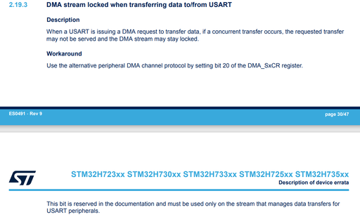

Problem Description:
MCU Model: STM32H723VGT6
DMA Configuration:
  • DMA1/DMA2 handles 15 DMA channels in total:
    • 5 UARTs (TX + RX)
    • 4 additional UART RX channels
    • 1 PWM channel (TIM15 CCR1 via DMA)
      Observed Failure:
      After 10–60 minutes of normal operation, ​all peripherals using DMA2 stop functioning:
  1. UARTs: RX overrun errors occur (ORE flag set in ISR).
  2. PWM (TIM15 CCR1):
    • DMA circular mode remains active (Half/Complete Transfer interrupts trigger normally).
    • SxNDTR counts correctly, but ​CCR1 register data never updates (verified via debugger).
  3. No DMA Error Flags:
    • TEIF (Transfer Error), FEIF (FIFO Error), and other error flags in DMA_LISR/HISR remain cleared.
Key Observations:
  • Failure ​suggests DMA2 loses access to data bus without triggering error detection mechanisms.
  • Issue persists across multiple boards, ruling out hardware defects.
Troubleshooting Performed:
  1. DMA buffer addresses confirmed in AXI SRAM (0x24000000) with MPU full-access permissions.
  2. Interrupt flags (TCIF, HTIF) cleared properly in ISRs.
Request:
Has anyone encountered similar DMA2 silent failures? Any insights into:
  • Potential AXI bus arbitration conflicts?
  • Hidden errata related to DMA2 bus access?
  • Debugging techniques to capture transient bus faults?
Thanks in advance for your expertise!

Hello @peter_zhly and welcome to the community;
Do you have the same issue when all USART are disabled?
Could you please check if this errata is respected or not in your project code?
Thank you.
