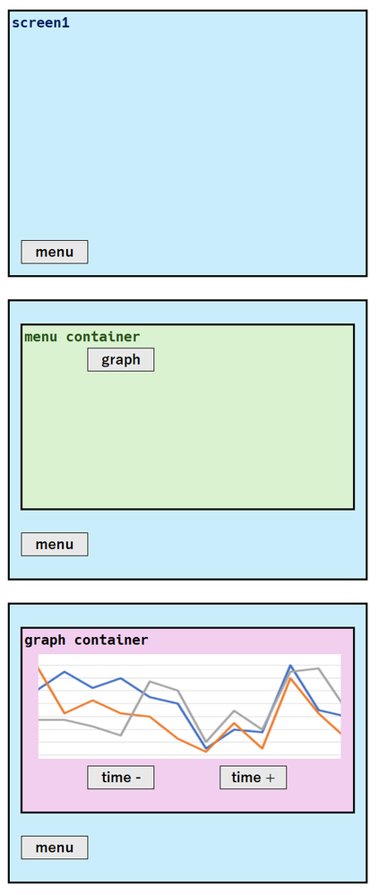

I'm developing a UI on STM32H750 using TouchGFX with a 1024x768 display. I'm experiencing significant performance issues with touch responsiveness when displaying graphs.
My UI Structure:
  1. Base screen (screen1) with a menu button
  2. When menu button is pressed, a menu container is displayed on top
  3. The menu container has a graph button which opens a graph container that overlays on top
  4. The graph display uses a CacheableContainer with multiple static graphs
The Problem:
When the graph is displayed, touch response becomes extremely slow. I've used CacheableContainer which helped slightly, but issues persist.
In the simulator, I discovered that during every tick, the entire screen (full rect 0,0,1024,768) is being redrawn unnecessarily. The CPU usage spikes when the graph is displayed.

Further Details:
  • The drawing process is redrawing screen1, menu container, and graph container in sequence during each tick
  • The graph only needs to update every 10+ seconds, not on every frame
  • All this unnecessary redrawing is causing significant performance overhead
Question:
Is there a more efficient way to handle drawing in this scenario? How can I prevent the entire screen redraw on every tick when only small portions need updating?

Is your frame buffer memory cached?
Is the background an image or a rectangle object? Loading a rectangle is faster than an image.
Perhaps 1 idea is to have the background have a cutout (4 rectangles) so it doesn't need to update the background.

Thank you.
The problem with my program was that unnecessary invalidate() calls were occurring every time.
After fixing it so that hidden parts are not refreshed, the performance improved.
Thank you for your kind answer.
