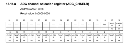

I want to measure ADC on multiple pins. I don't need DMA, just measure PA0 then measure PA2. Measuring PA0 works, but when I switch the channel to 2 it still measures from PA0:

For rank I tried 0, 1, 2, ADC_RANK_CHANNEL_NUMBER. Still only measures PA0 not PA2.

  sConfig.Channel = ADC_CHANNEL_0;
  sConfig.Rank = ADC_RANK_CHANNEL_NUMBER;
  if (HAL_ADC_ConfigChannel(&hadc, &sConfig) != HAL_OK)
    Error_Handler();
  sConfig.Channel = ADC_CHANNEL_1;
    Error_Handler();
  sConfig.Channel = ADC_CHANNEL_2;
    Error_Handler();

Without DMA, you can only convert one channel at a time. When you reconfigure for channel 2, you need to disable channel 0.
Easiest way would be to modify CHSELR directly to have a 1 in the bit you want to convert and 0 everywhere else.

I only need to measure 1 channel at a time, so this is what I used and it works now:
CLEAR_BIT(ADC1->CR, ADC_CR_ADEN);
ADC1->CHSELR = ADC_CHSELR_CHSEL2;
SET_BIT(ADC1->CR, ADC_CR_ADEN);
