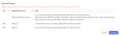

I am using the EVLSERVO1 board with a differential quadrature encoder (A and B phases). The encoder has a resolution of 4096 pulses per revolution, and I am observing issues when the motor speed exceeds a few hundred RPM.
Specifically, the system becomes unstable above ~500 RPM. The motor fails to spin reliably, and the encoder appears to stop providing meaningful feedback(past 500 rpm, the encoder value stays the same about). However, when I probe the differential signal (A+ minus A−), the waveform looks clean on the scope.
Is this behavior expected due to the encoder being considered "high resolution"? Would performing the rework suggested for high-resolution encoders (replacing R81 and R82 with 330 Ω...) help resolve this issue?
I am unsure where the resolution or frequency cutoff is that necessitates this rework, and would appreciate any guidance.
Thank you!
There is no "cutoff" - its more like a "taste group".
So our new friend says:  whats low res.enc. ?
examples: Rotary encoders with 100-500 PPR or linear encoders with resolutions above 50 um.
and > 1000 PPR is then high resolution.
e.g. the encoders for speed checking have typical 16 .. 64 PPR (we use in machines rotating at 50...2000 rpm).

so with your high resolution set the r81/82 to 330 , then check again.
(So less load on the encoder data lines, bigger signal, better for high resol. frequencies ;)

Before I do the suggested rework, I wanted to clarify what is generally considered a high-resolution encoder? I am not sure where the cutoff is, but is 4096 pulses/rev considered high or low resolution?
Thanks!
