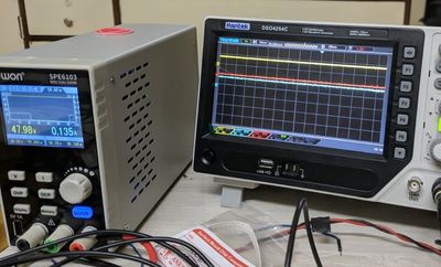

Second, we now tried to spin the motor with Hall sensor as Speed Sensing Mode and clicked "Start" button under the Control from Motor Pilot. While there was about 0.14A of current drawn from the power supply when we started the control, absolutely no action in the Motor. Waited for a while, before stopping or resetting the operation, and rotated the rotor manually by hand and now Speed Feedback Error showed up. Obvious to note, the motor still didn't spin. Just so you know, we got the Hall angle placement right (mechanically and electrically). Got each of the sensor checked and they are working fine too. They are also connected to appropriate 2,3 & 4 Pins respectively of CON8 on STEVAL-006V1. Also to note, this exact motor was spun using a different controller to validate and verify the unknowns from the Motor side and resolve if any. Motor is fine.

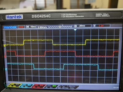

Hello @AkhilDP.,
Could you please send a scope display of the H1/H2/H3 signals on NUCLEO-G474RE running the main=sto-pll - aux=Hall use case when motor is spinning (few cycles and scope channel - Hx signal correspondence)?

Hello @GMA ,
Sure, Below are the snaps of the oscilloscope for the Hall Feedbacks.
Img1: Main: STO-PLL, Aux: Hall. This is while the motor is spinning
 Img2: Main: Hall. (motor isn't spinning, hence no change in the Hall states. H1-1, H2-0, H3-1). Please note that the current is still getting drawn from the power supply as I mentioned about it earlier.
Hello @AkhilDP,
According to the scope, the "Sensors displacement" is 120°, is-it your used setting?

Hello @GMA ,
Yes, Precisely. That's the setting I used.
As I had mentioned earlier we did all the necessary steps as provided in the Launch Workbench 6.1.2 -> About -> Documentations -> User Manual -> Hall sensor feedback processing.

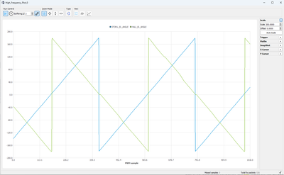

Hello @AkhilDP,
Coming back to your first trial figure, switching motor U and V phase signals I have the same result as you on your first shared plot:
If I understand correctly, HALL sensor signals have been modified to align both electrical angles, but it seems that motor phases were not correctly connected... Could you try setting H1,H2,H3 as on your first trial but using U,V,W phases to align both electrical angle?

Hello @GMA ,
As suggested we set our H1, H2, H3 as per the first trial and interchanged U & V. By doing so the motor spun in opposite direction and both 'STO_EL_Angle' and 'Hall_EL_Angle' followed the same pattern but weren't aligned. The Placement electrical angle had to be changed to get them aligned. But the motor still didn't run in Main:Hall Sensor Mode and behaved as usual drawing some amount of current without spinning.
