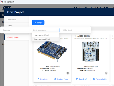

Hello kamalskdy,
Unfortunately, driving two motor with a NUCLEO-F429 and an IHM07 will prove to be difficult. I suggest you to run the MC WorkBench and try looking at all the supported boards for Dual Drive control before deciding on any setup.

Gael A
December 4, 2024
Hello kamalskdy,
If you want to run a motor without using the MCSDK, then we will not be able to provide any support. Maybe another user on the forum will be able to answer your question.
The only advice I can give you is to have a look at the MCSDK implementation for PWM generation and get only the part that you need from this.
