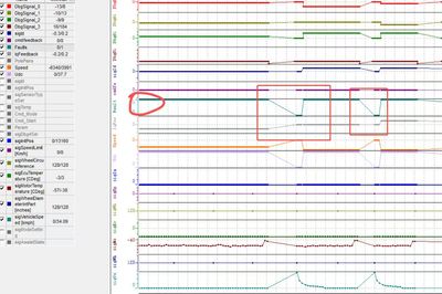

After disabling the VDS monitoring protection function by setting the SCREF input to VDD, I drove the motor and found that the motor has been shaking continuously. This issue has remained unresolved. Every time I replace a new MCU or controller, I only perform power on/off operations, and after about 20-30 times, a VDS fault is directly reported, with the fault bit set to 1. I'm not sure why this is happening yet. Could you please provide some guidance? Thank you
 You can see ,the fault vds is contiune  show 1 while i perform power on/off operations.
你好  并没有取消,我已经把vds监控的电流放开了,但是还是上点就报fault,而且没有驱动电机,只是上电,就报故障了
