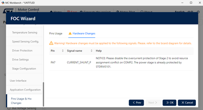

pelino
If this is configured incorrectly, will it trigger overcurrent protection?

I am using a dual-motor configuration. Is there a method to identify which motor triggered the overcurrent error?
Hello @pelino,
To identify which motor triggered the overcurrent error, load MC_FOC_SDK_2_Motors.qml GUI on Motor Pilot Tool.
For M2 Over Current detection, the feature is provided by STDRIVE101 chip as mentioned on WorkBench interface:
