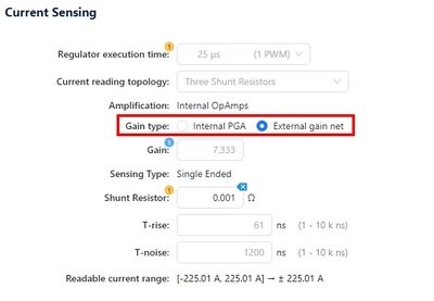

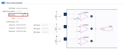

I'm currently using the EVSPIN32G4 evaluation board along with MC Workbench for motor control development, and I'm encountering an issue with Overcurrent Protection (OCP) behavior that I can’t quite resolve.
My Setup:
Gain Type: External Gain Net
OCP Threshold (set in MC Workbench): 200A
Shunt Resistor: Physically modified to 1mΩ (0.001Ω)
External Amplifier Gain: 7.33
During runtime, I monitored the motor phase current using a current probe and oscilloscope. OCP is triggered at only around 46A, which is far below the configured 200A.

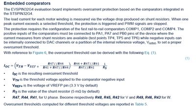

In the official ST document UM2850 - Getting Started with EVSPIN32G4, Section 5.5.2 provides a OCP threshold formula.
The formula is used to calculate the actual overcurrent protection (OCP) trigger current based on the hardware resistor network.
I’m unsure whether this discrepancy is due to a misunderstanding on my side, or if there’s a misconfiguration in the setup.I hope someone can help me clarify this issue.

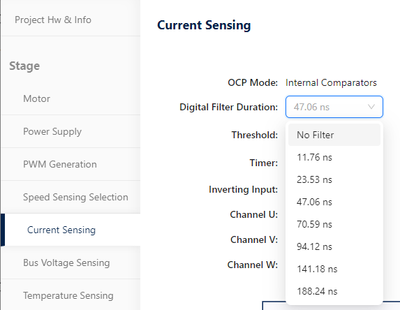

How did you measure the 46A current value? The most accurate is to measure with a scope the voltage at Rshunt point.
Signal could be noisy; could you try by increasing the Digital Filter Duration?
