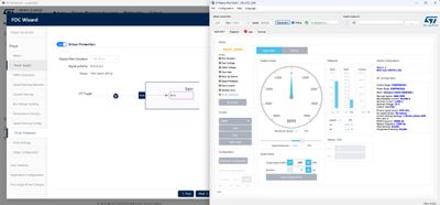

Hello @ClyneModa,
Driver protection error is reported in the MC Pilot interface if feature is enabled:
An associated comment is added in the next MCSDK delivery user manual to describe the error source.

Hello @ClyneModa,
PE15 nFAULT pin is not described in the project (driver protection).
Refer to the STSPIN32G4 datasheet for the nFAULT description and to the EVSPIN32G4 board description for the driver protection feature definition.
You can check if nFAULT is triggered when you start the motor.

Hi @GMA,
Thank you for the suggestion. I connected my debugger to the board and watched the status of GPIOE_IDR during firmware execution. nFAULT is low and READY is high during RUN state, so there was a fault being triggered.
nFAULT indicates thermal shutdown, VCC UVLO, or VDS monitoring by default. Thermals have not been observed to be a problem, and VCC UVLO is ruled out since READY is high, so VDS monitoring was the issue here.
For now, I have disabled VDS monitoring by shorting SCREF to 3.3V. This led to Motor Pilot detecting Over Current faults when I START the motor, which I fixed by reducing my ADC sampling time to ~500ns. The motor does not spin yet, but there are no faults and I hear the motor produce a loud tone; my issue now must be with alignment or something beyond the scope of this post.
