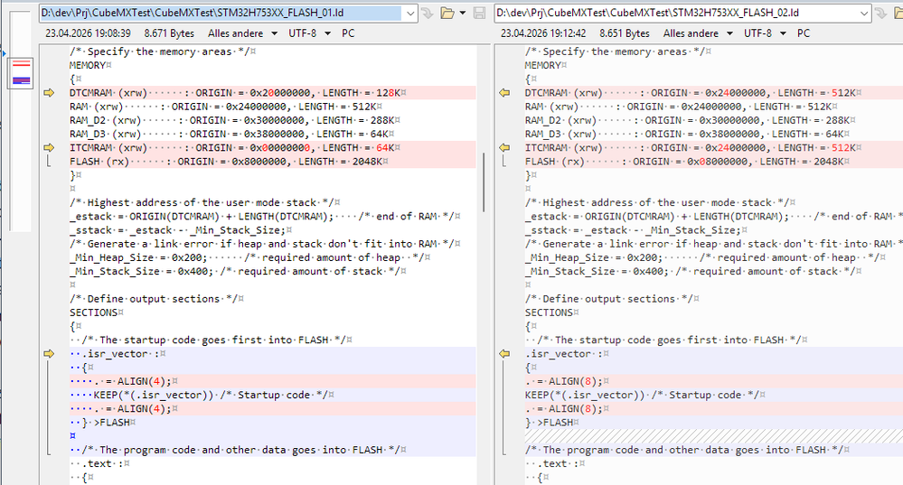

  8. Check the file size of STM32H753XX_FLASH.ld file (in my case: 8671 Bytes)
  9. Make a *copy* of the STM32H753XX_FLASH.ld file to STM32H753XX_FLASH_01.ld for later compare, but don't delete the file.
  10. In STM32CubeMX Go to Tools / Memory Management
    - Switch Apply Application Regions Settings to Peripherals On
    - Switch Apply Application Regions Settings to Linker Files On
  11. File / Save Project
  12. Generate Code
  13. Check the file size of STM32H753XX_FLASH.ld file (in my case: 8651 Bytes)
  14. Make a *copy* of the STM32H753XX_FLASH.ld file to STM32H753XX_FLASH_02.ld
  15. Compare the file _01.ld file from step 9 with this _02.ld file:

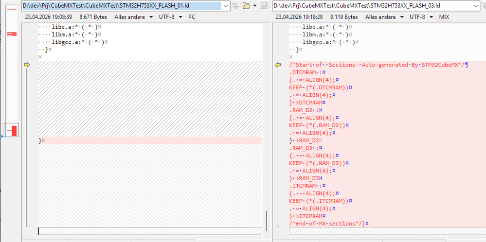

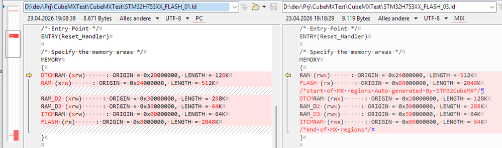

  16. *Delete* the STM32H753XX_FLASH.ld
  17. Generate Code again and open STM32H753XX_FLASH.ld file again

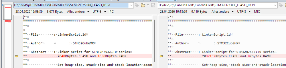

  18. Check the file size of STM32H753XX_FLASH.ld file (in my case: 9119 Bytes)
  19. Make a *copy* of the STM32H753XX_FLASH.ld file to STM32H753XX_FLASH_03.ld
  20. Compare the file _01.ld file from step 9 with this _03.ld file:
The regions are now available.
However, according to the comment header, the controller has now much more flash memory, but zero RAM :)

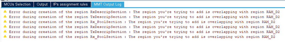

The next behavior occurs if the ETH module is switched on (to RMII) after the MMT is still activated.
The error appears in the MMT output log:
However, if you switch to Tools / Memory Management, the output view is disabled.
When you turn it back on, the content is empty:
until you switch the ETH off and on again, you will see both the new and old errors:

Concerning the error encountered when enabling ETH after using the MMT tool, this behavior is expected. The message is intentionally generated to alert the user about a memory region overlap detected by MMT:
"Error during the creation of the Rx_PoolSection region: The region you are trying to add overlaps with the RAM_D2 region"
This indicates that the Rx_PoolSection required by ETH conflicts with the existing RAM_D2 memory allocation.
To resolve this issue, please update the memory mapping before enabling ETH by applying one of the following actions:
Delete the RAM_D2 region, or Relocate the RAM_D2 region to AHB SRAM2 or AHB SRAM3
Once this adjustment is made, ETH can be enabled without triggering the overlap error.

Regarding the second "issue" (ETH/MMT): now I know how to handle it and what I should do.
I just wanted to report this to ST because I don't think STM32CubeMX is very user-friendly in this regard. And it took me a while to figure out what I had done wrong, since I didn’t notice the first error message and the message was no longer visible after switching between tabs.
If the error message were displayed permanently until the issue is resolved, this would be beneficial for all users.
