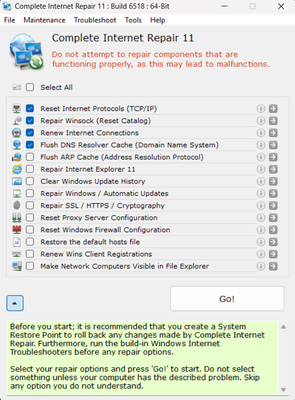

It's FIXED !!!!!!!!
It was indeed a winsock problem and I fixed it by installing a simple app called "complete internet repair" from Rizonesoft.
I selected these options and when it's done I rebootedmy pc and IT WORKED !
Thank you for trying to fix it with me, the winsock hint was very helpful.

I think it is a Winsock API error,
I have this in winsock show catalog which is from another app I did uninstall it before. (LabView from National Instruments)
I tried deleting it from regedit and the moment I reboot, windows crashes and wont boot, I had to recover from a restore point.
Also, I found a dll file with the name nimdnsNSP.dll which I did delete it (only been able to inside safe mode)
