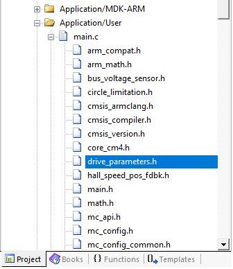

I have the code generated by MotorControl Workbench compiling in STM32CubeIDE and it programs and runs the motor. I managed to get the motor running at the speed I want, but I've been having a hard time making some adjustments to the parameters which are distributed through various folders and files. In particular, I want to change the initial acceleration rate after boot up. How/where is this controlled?

Thanks for your reply. I've been trying to adjust many of the values in that file as well as many others, but am not able to change the acceleration.

Hello @Angelo Quattrociocchi
In drive_parameters.h file, you can change the acceleration by acting on the below table with the following considerations:
- Phase 1 is the alignment step: its final speed must be 0
- At least three steps must be configured
- OBS_MINIMUM_SPEED_RPM must be less than the final speed of the last acceleration step
/****************************** START-UP PARAMETERS **********************/
/* Phase 1 */
#define PHASE1_DURATION 500 /* milliseconds */
#define PHASE1_FINAL_SPEED_UNIT (0*SPEED_UNIT/U_RPM)
#define PHASE1_VOLTAGE_RMS 4.15
/* Phase 2 */
#define PHASE2_DURATION 1000 /* milliseconds */
#define PHASE2_FINAL_SPEED_UNIT (600*SPEED_UNIT/U_RPM)
#define PHASE2_VOLTAGE_RMS 10.41
/* Phase 3 */
#define PHASE3_DURATION 500 /* milliseconds */
#define PHASE3_FINAL_SPEED_UNIT (600*SPEED_UNIT/U_RPM)
#define PHASE3_VOLTAGE_RMS 10.41
Regards

‎2025-05-04 3:38 AM
Thank you ADAVE.1, that was a very helpful document. Somehow I never came across that during the research I was doing on this device and SDK. But it helped me understand and adjust the parameters to get a pretty good and stable operation.
