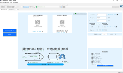

The motor parameters of the compressor obtained from the pilot are inaccurate
wcx8229
Why are the motor parameters of the compressor analyzed by Motor Pilot_6.4.0 so different from those described in the compressor specification?
The attachments are a screenshot of the analysis results from Pilot and the compressor specification.
If I have any misunderstandings, please help me to correct them.
 for example,
Polot get:
Ls 7.21mH, Inertia 108.8
spec. of compressor:
15.6mH , 230

Hello @wcx8229,
The Motor Profiler Tool is an estimator designed to simplify the motor control development process.
You can update the generated motor JSON file with either specified values or precisely measured values using an RLC meter.
