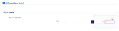

Hello @AngHung,
The example can be fully generated with MCSDK 6.3.2 or 6.4.0 version, just select the board and your motor if you profiled it, and enable the Electronic speed control from the "Stage configuration" :
If you need to profile your motor, then enable the motor profiler from "Application Configuration". Be careful that profiler project cannot work conjointly with ESC enabled.
My advice is to generate your project without ESC enabled first and check with the motor Pilot if you can control your motor as expected. Once it is Ok, re-generate your project with ESC enabled.
If it works with MC Pilot, but not with PWM control, your issue is the PWM shape you apply that is not aligned with the esc state machine that you can find in esc.c.
Please have a look at the following post : Solved: Re: STEVAL ESC001V1 PID Tuning - STMicroelectronics Community
