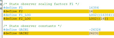

During Porting software, in sensor less speed measurement using STO-PLL observer I did not get any idea for the parameters F1, F2, gain1 and gain2 parameters from user manual (STM32 motor control SDK user manual) and software code too. could you help me to understand how these parameters are computed by workbench by using motor parameters. this will help me lot.

                      I have ported software of dual FOC from STM32F415zgtx to STM32F767ZI using workbench 6.4.0 and also able to drive two motors. But if I need to use sensor less speed measurement it is required for me to understand these parameters. could you please help me to understand the parameters F1, F2, Gain1, Gain2 and hf3(C6_COMP_CONST1 and C6_COMP_CONST2). I am able to find the values of gain1 and gain2 but for that sometimes I need to do addition or subtraction in the formulas of K1 and K2. Not getting any idea when to add and when to subtract.
