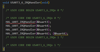

hello,
now I am using stm32f030cct6 to design a simple program. i used all the 6 uarts of this chip. it works fine, but the interrupt code generated by STM32CubeMX has a simple bug.
the code as below.
for the uart6, there is a useless (&huart6);  i think it is no effect to the function, but when building, there is a warning.
stm32f0xx_it.c:172:33: warning: statement with no effect [-Wunused-value]
[build]   172 |   HAL_UART_IRQHandler(&huart6);(&huart6);
[build]       |                                ~^~~~~~~~
I dont like the warning.
so i think you can simplly fix this bug.
thanks.

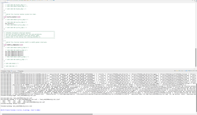

Hello @dqsh06
After performing a test using STM32CubeMX 6.16.1, I obtained no compilation errors and STM32CubeMX behaved as expected.
Could you please retest on your side using STM32CubeMX 6.16.1?
I have attached my .ioc file for your reference, in case it helps reproduce the behavior.
Thx
Ghofrane

hello @Ghofrane GSOURI
i used the stm32cubeMX version 6.15.0. i think your guys had already fixed it with the new version. it is good.
Thanks,
