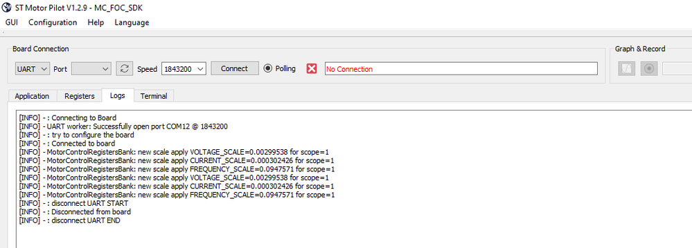

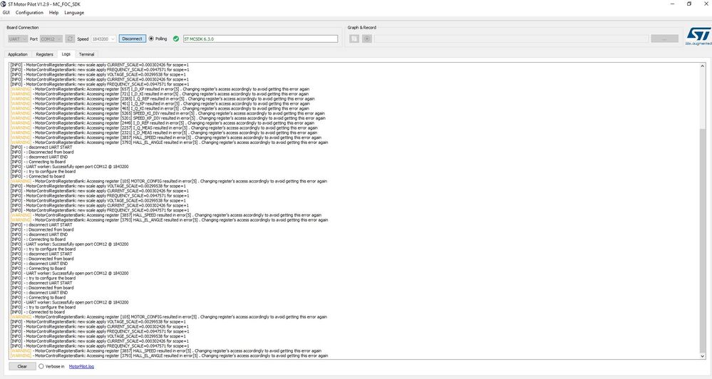

Today I checked a lower PWM frequency (16 kHz -> 4 kHz). Almost same motor performance result. See attached movie.
Please note the screencopy of Pilot log data; is this normal?

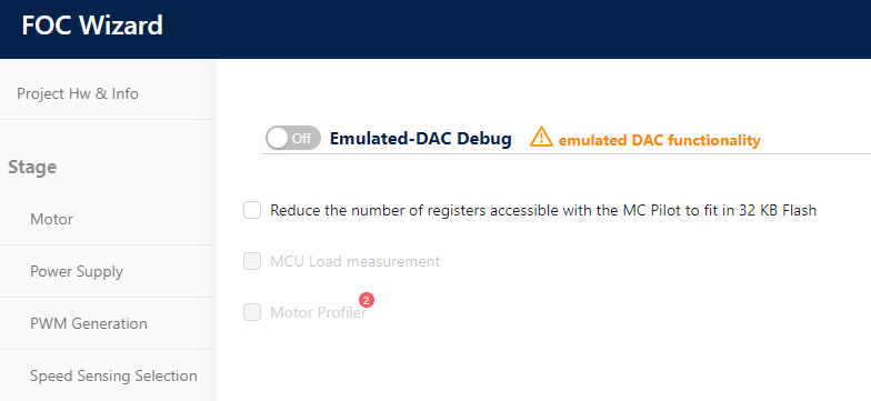

Some update.
The warnings can be solved by not setting the following option in MC Workbench
But the performance of the motor is still the same (first CW, then CCW, then communication error at USB)
See above log.
