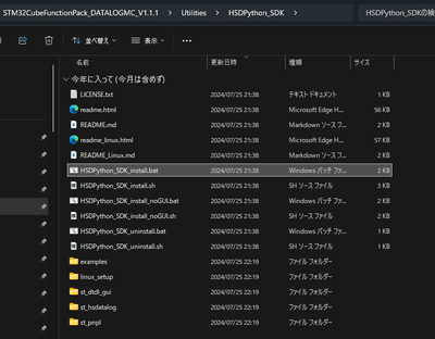

Installation error of FP-IND-DATALOGMC
hamaogeoge
STM32CubeFunctionPack_DATALOGMC_V1.1.1をwebからダウンロードし
Downloaded STM32CubeFunctionPack_DATALOGMC_V1.1.1 from the web.
en.fp-ind-datalogmc\STM32CubeFunctionPack_DATALOGMC_V1.1.1\Utilities\HSDPython_SDK\HSDPython_SDK_install.bat
を実行すると
When I run en.fp-ind-datalogmc\STM32CubeFunctionPack_DATALOGMC_V1.1.1\Utilities\HSDPython_SDK\HSDPython_SDK_install.bat
以下のようにエラーが出ます
このエラーを解決したいです。python3.13をインストール済みです。
HSDPython_SDK Installer
I get the following error
I want to resolve this error. I have already installed python3.13.
When I run HSDPython_SDK Installer

SimonePradolini
Hello @hamaogeoge
I'm sorry, but Python 3.13 is not supported due to a dependency to PySide6 Python package.
As a consequence, HSDPython_SDK is compatible with Python 3.12 up only.
Can you try the SDK by installing Python 3.12?
Best regards
Simone
