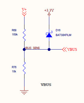

I am referring to the B-G431-ESC1 source code and i feel there is an error in the battery voltage measurement source code. A conversion factor is used to convert from the ADC voltage to the battery voltage. It is initialized as follows
RDivider_Handle_t BusVoltageSensor_M1 =
._Super =
.SensorType = REAL_SENSOR,
.ConversionFactor = (uint16_t)(ADC_REFERENCE_VOLTAGE / VBUS_PARTITIONING_FACTOR),
The voltage is read in u16Volt format when reading the ADC register value , I assume the adc driver will only give max value of 12Bit (4096) for 3.3V, but where is this conversion added to convert to Battery voltage. Please advise.

‎2023-03-09 6:49 AM
Hello @Community member​,
The ADC is configured to be left aligned, so the maximum value is actually 0xFFF0 = 65 520
The conversion you are looking for is done in function function VBS_GetAvBusVoltage_V from bus_voltage_sensor.c file.

‎2023-03-10 7:09 AM
Thank you very much got response from ST employee, which will help to clarify our doubts and move forward more confidently.
As per the circuit, the maximum Battery voltage = 3.3/0.096 = 34.375V appx.
So if i receive the ADC count of 65520=0xFFF0, the max voltage is 34.375V
and if i receive a adc count of 32768 = 0x8000, the voltage is 17.18V. Am i correct? Please advise.
‎2023-03-10 7:40 AM
I do not see any issue with your computation.
Please note that the Pilot reads volt in unit16_t so you will have only integer values. in your case you should read 17 V.
Hope it helps.
Cedric
