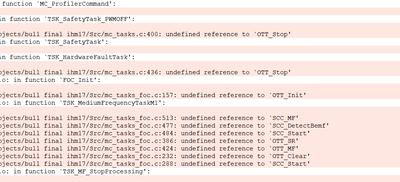

issue : Error in stmcubeide when generating motor profiler code with MC Workbench 6.3.0
what will be the reason ?

@hashiR wrote:what will be the reason ?
Exactly as it says: you have not defined those symbols - therefore, they are undefined.
Have you omitted the file(s) which would define them?

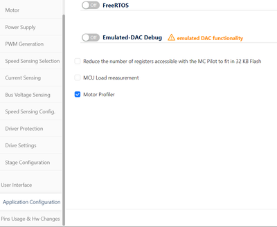

When I check the 'Motor Profiler' box in Motor Control Workbench (v6.3.0) and generate the code, errors appear in STM32CubeIDE (v1.16.0). However, when the 'Motor Profiler' box is unchecked, everything works fine.
