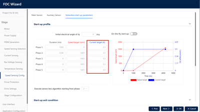

Hello @ElGuerrero91,
Thank you for the digital filtering setting issue report. This point will be reported to the dedicated team for correction in future deliveries. In the meantime, copy the generated value of MotorControl.M1_OCP_BKIN_FILTER, defined in the .ioc file, into the TIM1 initialization code in main.c:
static void MX_TIM1_Init(void)
  sBreakDeadTimeConfig.BreakPolarity = TIM_BREAKPOLARITY_HIGH;
  sBreakDeadTimeConfig.BreakFilter = 4; /* Value to be updated */
  sBreakDeadTimeConfig.BreakAFMode = TIM_BREAK_AFMODE_INPUT;
  if (HAL_TIMEx_ConfigBreakDeadTime(&htim1, &sBreakDeadTimeConfig) != HAL_OK)
    Error_Handler();
For overcurrent, reduce the current target.
If you agree with the answer, please accept it by clicking on 'Accept as solution'.
Best regards.

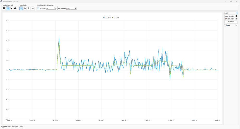

ElGuerrero91
Thank you for forwarding this issue for further investigation.
In the meantime, I checked whether my current‑measurement setup might be contributing to the behavior. Could you please take a quick look at the attached screenshot of Iq_Meas and let me know if this level of noise is considered normal? Even when Iq_Ref is stable, I see approximately 2 A peak‑to‑peak noise on Iq_Meas. Is this expected?
If not please can you let me know what should I check further?
Thanks a lot.
