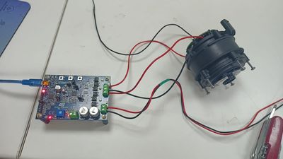

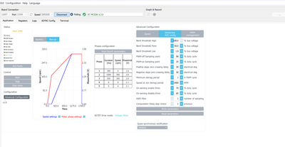

While trying to operate the motor we are not able to go beyond the alignment phase. When we start it it just aligns and then stutters and comes to a halt. We get an overcurrent alert every time.
We have followed all steps ( board setup, motor parameter setup) according to the documentation available at MCSDK Wiki.

Hi arpituee, there are two ideas that could help.
1. Depending on the 6-step driving mode you configured with the MCSDK6.3.0 workbench, you need to set up a specific jumper JP8 on the board as described into the user manual UMM2278 STEVAL-SPIN3202 - STSPIN32F0A advanced 3-phase BLDC driver with embedded STM32 MCU single shunt evaluation board - STMicroelectronics:
- Current driving mode configured into the MCSDK6.3.0 workbench implies no current protection. In consequence the jumper connected on JP8 between is set between pin 1 and 2 (named six-step position) for current driving mode.
- Voltage driving mode configured into the MCSDK6.3.0 workbench allows to set up overcurrent protection. For that purpose, set the jumper connected on JP8 between pin 2 and 3 (named FOC position). If it is your configuration, please check this JP8 hardware configuration.
2. You can also change the time, voltage and speed into the two phases 2 and 3 of the rev-up (generally by decreasing voltage and speed if overcurrent error pop-up). Please have a look to this document for more information:STM32MotorControl:6-step - Optimization and troubleshooting of sensor-less firmware parameters - stm32mcu.

Hello Fabrice,
We are able to operate the motor, thanks for the suggested changes ( JP 8), also I realised we were making a very basic error on the motor end, which when rectified the motor is now spinning perfectly.
