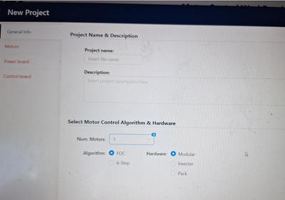

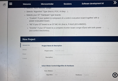

Hi Zied,
good news... we appreciate configuring our custom boards more easily...
However, when we are looking on version 6.2 we don't see the window as shown in the wiki see attached.
Thanks in advance for helping us.
Kind Regards#
Guenther
here the doc window:
thats what we are seeing on 6.2
Zied b.Author
October 24, 2023
hi @Gboost ,
The interface changes a little, but the parameters remain the same, the same functionalities are offered to the user.
Regards

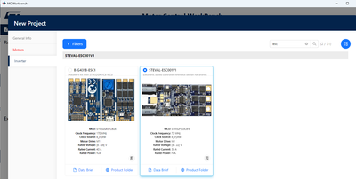

Where can i find STEVAL-ESC001V1 in MCSDK ?
GMA
October 28, 2024
Hello @tejas_amp,
Please, do not use an old post to add a new question.
Creating a new post prevents to sending messages to all users thread. STEVAL-ESC001V1 is available in Inverter tab.
