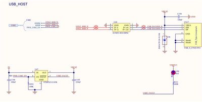

I'm working on implementing USB UVC on the STM32N6570-DK board. I generated a project using STM32CubeMX only for FSBL and added the following files manually from the ST USBX example project

Issue:
When I flash the my project to the STM32N6570-DK board, the USB device is not enumerating as a UVC device it does not appear in the Windows Device Manager at all.

Hi @saikumar
I assume in case, you don't use UCPD peripheral, you need to make some hardware change in schematics to pull down CC lines with 5.1KOhms and reconfigure TCPP port to type C only. Otherwise, use the second USB controller as implemented type C only.

Hi @saikumar
