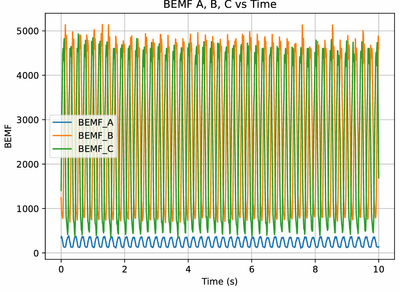

Hi all I'm going to reply to myself and provide an update as I've made a bit more progress.
No progress made so far on the current sensing ADCs but I shifted focus to the BEMF ADCs. I disconnected R60, R62 and R63 from the driver shield and now they all seem to exhibit some behaviour when I spin the motor by hand. I believe currently two of them are correct, PC4 and PC5, after all conversion they read ~0.66V which is what I verified as correct with the multimeter when the motor is not moving, however, PC3 reads ~0.06V at this time. Also when I turn my power supply on the PC3 value changes like the others do but is static and won't change as I spin the motor by hand.
It's worth noting the differences in setup between PC4, PC5 and PC3. PC4 and PC4 are on ADC2, configured as 14bits with a 2 bit left bit shift. PC3 is configured on ADC3 which has max resolution of 12bits. I selected for it to have a 4 bit left shift so I could do the same conversion as the others however applying any left bit shift I noticed doesn't change the raw ADC value.

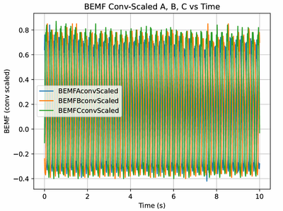

Hello again, @AScha.3 @GMA ,
Made some more progress today,
I've moved on from trying to configure adc3 with the bitshift. I've scaled them all differently and applied an offset value to line up 0 with the floating disconnected value. I'm not sure if this is the correct approach as you can see in the BEMF converted figure, what I believe is a phase-neutral measurement now has some negative value because of the offset, I'm not sure if this is acceptable or not.
@GMA mentioned validating the measurements with a scope. I noticed that when I spun the motor with a hand drill, the ADC pin would measure (with an oscilloscope) a 0.4V p-p reading whereas in software it would be ~1V, I'm not sure if my conversion is wrong, I am just doing a simple voltage divider calculation between R39 and R36.

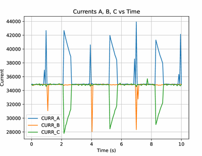

Additionally, I had a question about converting the current sensing adcs, I was able to get the following data in the currents, A, B, C figure but am unsure of how to convert this into meaningful data.
