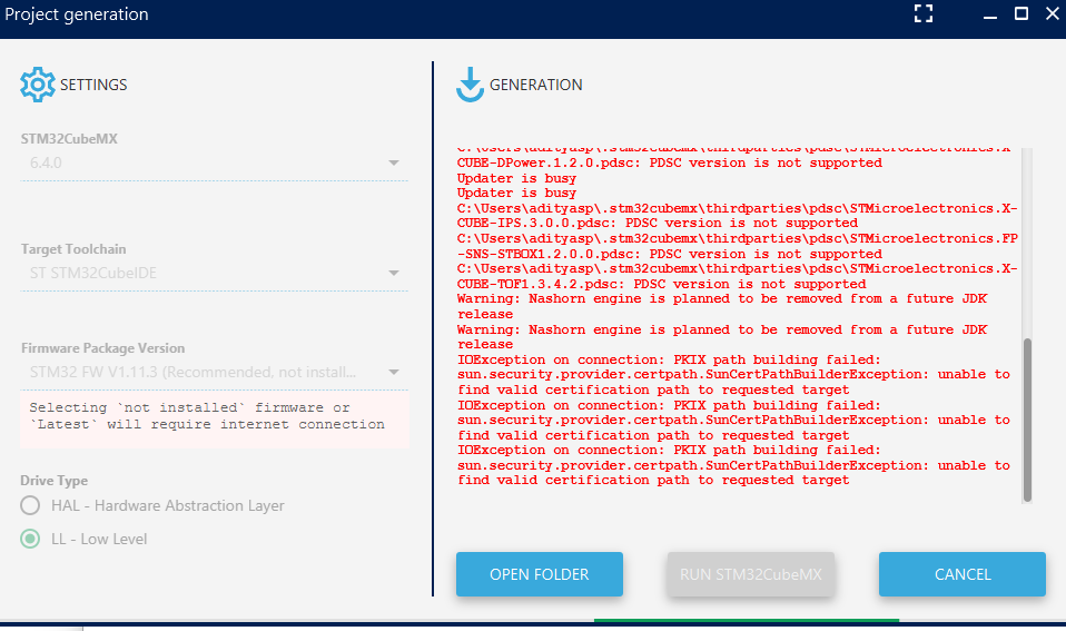

PDSC version is not supported.
Aditya_sp
2 REPLIES 2
GMA
Hello @Aditya_sp,
Could you please try by using a "Firmware Package Version" already installed or installing the "STM32 FW V1.11.3" as required by the tool (Open STM32CubeMX, "Help">"Check for updates").
If you agree with the answer, please accept it by clicking on 'Accept as solution'.
Best regards.
GMA
lucifer
delete mentioned psdc files
