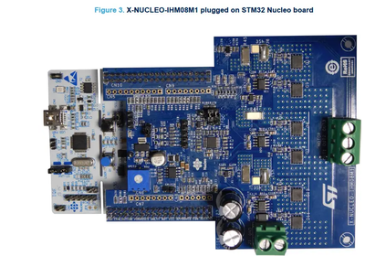

I'm in the process of configuring my STM32H723ZG to work with the IHM08M1 motor driver shield.
Currently I am trying to configure and validate the signals from the ADCs however I am having some issues with this. One ADC I'm trying to validate is the DC voltage bus reading. This circuit simply places the input through a voltage divider with some protection, going straight to the ADC after. I've tried configuring these ADCs in a few different ways, single channel, DMA, etc. however none of them produce the expected results.

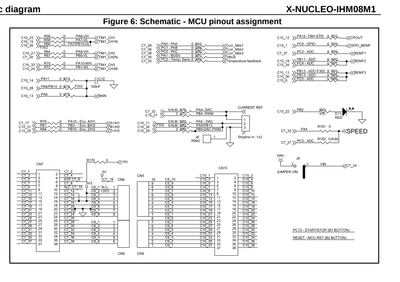

Hi AScha.3,
Thank you for your reply. I am seeking help with all ADCs, the specifc one I am referring to is for voltage bus measurements, configured on pin PA1. It is located in the top middle portion of the image you sent me. Attached is the assisting circuitry for the input.
Thank you for your help.
Schematic diagram
how did you connect to the H7 board ? (because its for morpho connector on nucleo64 boards fitted.)
I soldered two sets of header pins to the nucleo board to connect the
shield, ensuring that the pins specified in the motor drivers datasheet
lined up with those on the stm. This meant that the side with the buttons
on the nucleo was covered.

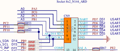

Ok,
so assuming you did it correct:
...seems, your "A1" is then PC0 on the H7 /144 board. Try this as the analog Vin.
see in circuit...and check on which pins you come out on this board !
https://www.st.com/resource/en/schematic_pack/mb1364-h723zg-e01_schematic.pdf
Hi AScha.3,
I will test this soon, are you able to explain how you came to this? I
lined up the stm and shield such that the pins specified would be the same.
I.e. under the nucleo board, it says PA1 on the pin where I expect PA1 to
be on the shield.
Are you suggesting that this correlates to a different pin in software?
Hi AScha.3,
With the help of the schematic you linked I was able to realise that SB57 needed to be removed. PA1 now works correctly but I am still having some issues with the pins used for current sensing. I have configured them on PA0, PC0, and PC1 for phases U, V, and W respectively. If you have any insight as to what might be wrong I would greatly appreciate your assistance.
Thanks again!
Hello @evanpol,
To use PC1 for current sensing, remove SB64.

Thank you for your help, I am using my own custom code to program the STM32H723ZG and control the IHM08M1, not MCSDK. Thank you for your comment regarding SB64, I have that solder bridge removed and have gone through the schematic ensuring that aren't any others that might be missed for the current sensor pins. I have configured the ADC properly now and am able to read a value, the value is floating and when I ground the pin or drive it to 3v3 I can see the respective correct ADC values. However when running my circuit I don't see any current feedback, and imagine that it should be floating closer to 0 instead of the middle of the ADC range, any help would be fantastic.
I tried looking at the BEMF measurements next, configured them all on PC3-C, PC4, and PC5. PC3-C looks like it worked straight away, spinning the motor by hand while disconnected to DC supply showed some voltage at the pin. However PC4 and PC5 were floating at the middle of the ADC range. I noted that in the schematic I may need to remove SB36 and SB29, I removed these and the behaviour seems odd? It's more or less the same but now reading for PC3-C also seems off, it doesn't change much when spinning the motor by hand and floats at an ADC value of ~2000.
