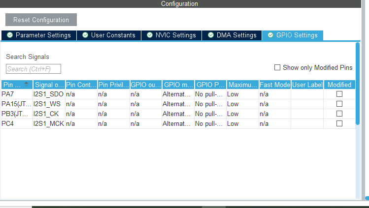

hello, i hope you are doing good. i am facing an issue in configuring i2s in dev board nucleo-h723z
issue i am facing is no clock at i2s2-sck pin.i tries all other i2s port also. i checked clock through logic analyzer .

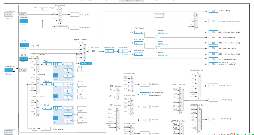

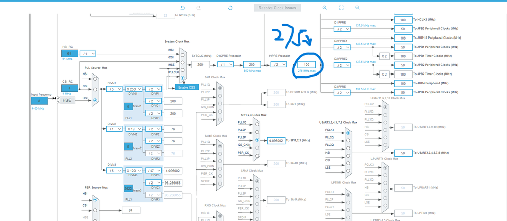

here is my clock configuration:

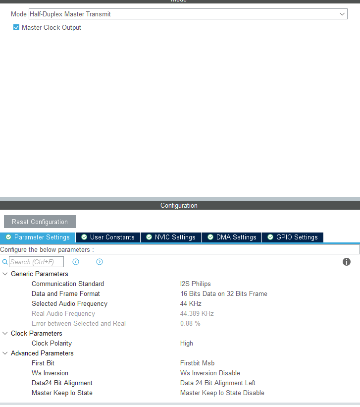

i2s configuration:
pins:
i tried other i2s2_sck pins also
code :

Did you step into the code, and check the GPIO pins and I2S peripheral are set up correctly ?
You should see the respective config register bits set.
yes gpio pin and i2s peripheral are set up correct you can see here:

    PeriphClkInitStruct.PLL3.PLL3M = 5;
    PeriphClkInitStruct.PLL3.PLL3N = 120;
    PeriphClkInitStruct.PLL3.PLL3P = 47;
    PeriphClkInitStruct.PLL3.PLL3Q = 4;
    PeriphClkInitStruct.PLL3.PLL3R = 2;
    PeriphClkInitStruct.PLL3.PLL3RGE = RCC_PLL3VCIRANGE_0;
    PeriphClkInitStruct.PLL3.PLL3VCOSEL = RCC_PLL3VCOMEDIUM;
    PeriphClkInitStruct.PLL3.PLL3FRACN = 2622.0;
    PeriphClkInitStruct.Spi123ClockSelection = RCC_SPI123CLKSOURCE_PLL3;
