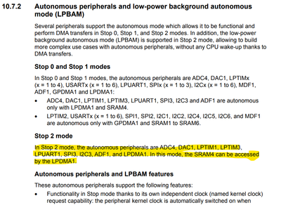

What should I pay attention to when I use stm32u5 FreeRtos stop2,
W
hen exiting stop2, do the relevant i2c spi adc uart peripherals need to be reinitialized?
Is the value retained?
Is there a routine for FreeRtos stop2?

Saket_Om
Hello @caiChangKun
Several peripheral support the autonomous mode and can run in STOP mode without CPU wakeup. Please refer to the reference manual
So you don't need to reinitialize these peripheral.
Below is typical sequence for entering and exiting STOP2 with FreeRTOS:
void Enter_Stop2_Mode(void)
    // 1. Prepare peripherals (stop ongoing transfers, etc.)
    // 2. Lock the RTOS kernel
    osKernelLock();
    // 3. Suspend SysTick
    HAL_SuspendTick();
    // 4. Enter STOP2 mode
    HAL_PWREx_EnterSTOP2Mode(PWR_STOPENTRY_WFI);
    // 5. Upon wakeup, reconfigure system clock
    SystemClock_Config();
    // 6. Resume SysTick
    HAL_ResumeTick();
    // 8. Unlock the RTOS kernel
    osKernelUnlock();
