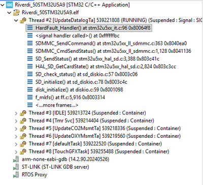

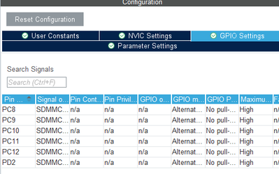

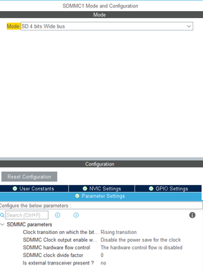

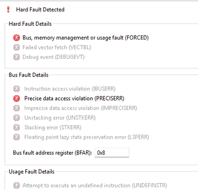

I'm attempting to write to an SD Card using a Riverdi STM32U5A9 display board.  Since TouchGFX natively uses FreeRTOS, I'm attempting to keep it within FreeRTOS.  Porting to ThreadX has caused it's own issues which I have in a separate thread.  In the Configurator, there is no longer an option for FATFS, so I'm using the STM32U5 Classic MW Git Repository as recommended by the FAE.  I copy over and update the templates as required, but am still getting a Hard Fault during f_mkfs while the HAL library is initializing the SDMMC.  I believe that my configuration is incorrect, but the example is only for SDRAM, so I'm not entirely sure where I've gone wrong...  I have it setup for 4-bit width and I've changed the clocks to be 24MHz at the SDMMC clock output.  The examples within the configuration are for older MCUs and have a tab to enable the DMA.  My understanding is that the STM32U5 has an Internal DMA, so it's not required to setup the DMA within the configuration.

co2meter
Update:
I've managed to get beyond this issue.  It turned out that CubeMX was not adding the SDMMC_Init to the main.  After adding, I no longer hard fault.  I now get FR_DISK_ERR at disk_write in ff.c during f_mkfs.  Still leads me to believe that there is an issue with the configuration.  I've lowered the SDMMC clock down to 12MHz, but that's not fixing the issue.
co2meter
Update:
Got it working entirely thanks to this post:
https://community.st.com/t5/stm32-mcus-embedded-software/buffer-overflow-in-cubemx-sdmmc-driver/td-p/426184
Enabling the Hardware Flow Control, setting the clock to 8MHz, and keeping it at 4bit width is working.
