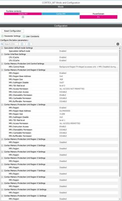

I'm working on an STM32H755ZIT6 project where I'm interfacing an SD card using SDMMC1 + DMA and FATFS (with exFAT) from the Cortex-M7 core. However, I'm facing a strange issue: the first time the board runs after programming, it writes and reads English text correctly to/from the SD card, but after one or two resets, the file content becomes garbled or shows Chinese-like characters instead of English. I suspect this may be cache, MPU, or alignment-related, but I'm not sure what I’m missing.

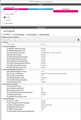

4. FATFS Middleware Settings (For Cortex-M7)
FATFS enabled under FATFS_M7
Filesystem: exFAT
LFN Mode: Static allocation, work buffer in .bss
Enabled DMA Template
Platform setting:

5. MPU and Cache Configuration
CPU I-Cache: Enabled
CPU D-Cache: Enabled
MPU Region 1 (AXI SRAM Region):
Base Address: 0x24000000
Access: Full access
TEX: Level 1
Shareable: Disabled
Cacheable: Disabled
Bufferable: Disabled
(MPU Region 0 is default)

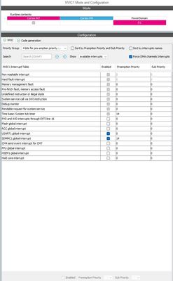

6. NVIC Settings
SysTick Timer Priority: 14
SDMMC1 IRQ Priority: 14

Just to see, cache is a problem: switch off D cache or not enable it.
And try setting higher priority for sdmmc, I use 3 , try.

The hardware, and the SDMMC / Card are agnostic to what the 8-bit byte contains. It doesn't care nor change Chinese characters or representations.
FATFS might need to accommodation for CODEPAGEs and legal characters you can put in short file names, and perhaps the Unicode in long file names. Check LFN is enabled.
Figure out and illustrate WHAT it is you're complaining about so we can focus on what the problem is, and where you should be looking.
‎2025-05-16 2:08 PM
Hi @Tesla DeLorean , thank you for your response. LFN is enabled, and I've also enabled exFAT. To clarify the issue: I'm writing an English string for instance,
[CORE_CM7]: Hello FATFS
to the text file, but when I open the file on my PC, the content appears as Chinese characters instead of the original English text.
