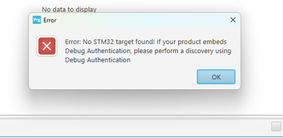

Hello STM32 Community,
I am a newbie and facing an issue with my NUCLEO-STM32H755ZI board.
I am unable to connect to the STM32H755 target using STM32CubeProgrammer, even though the ST-LINK appears to be working correctly,
Hardware
  • Board: NUCLEO-STM32H755ZI
  • Debugger: On-board ST-LINK
  • USB connection: CN1 (USB-A to Micro-B).
    Software
  • STM32CubeProgrammer: v2.21.0
  • OS: Windows
  • Connection mode: ST-LINK / SWD
  • Observed Behavior
    • ST-LINK is detected correctly by Windows
    • ST-LINK Virtual COM Port is visible in Device Manager
    • Target voltage ~3.27 V is shown in Cube programmer.
    • Green power LED (LD3) is
    • Red ST-LINK LED is blinking
    • Error: No STM32 target found!
      Unable to get core ID
      If your product embeds Debug Authentication,
      please perform a discovery using Debug Authentication

Did it work before? Did you flash anything?
Try connecting with setting: hardware reset.
Did you change/set the power supply setting?
Maybe then need start the bootloader by setting the boot0 high and then power up with dfu mode to recover to a working state.

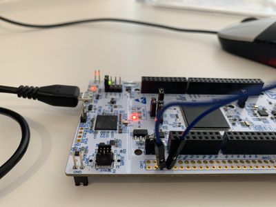

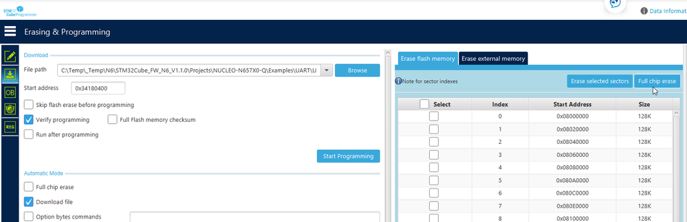

Try to connect to the bootloader and make a full erase of the flash.
1. Power off the board.
2. put a wire between pin 7 and pin 5 of CN11 => BOOT0 pin linked to VDD.
3. Power on the board.
If you haven't changed the default boot addresses defined in the option bytes, the STM32H7 will run the bootloader. You shall be able to connect with STM32CubeProgrammer.
2. Make a full chip erase.
3. Remove the wire => BOOT0 = 0 (Pull down resistor on the board => c.f. the board schematics)
4. Power off/on the board.
Now you should be able to connect and see the memory content as 0xFF => flash erased.
