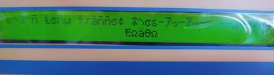

The display has a Hitachi HD44780 controller. After the startup, the strings the MCU sends to the display are correctly displayed. After date&time setting if the MCU sends a string with 5 ASCII characters (latin alphabet), the display displays 5 characters but they are not the correct ones ("HELLO" becomes something like "δπДДψ").

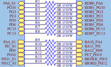

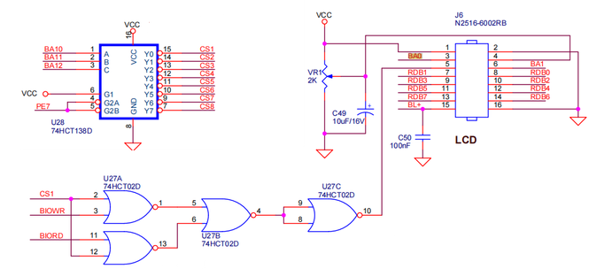

The parallel bus is connected as follows (left is the MCU, right is the peripherals side)
RDB0..7 are the data bus, BA10..12 are connected to a multiplexer used to select the CS for the LCD or other peripherals, PE7 is the CS (strobe of the multiplexer), BIOWR-BIORD are connected to logic ports (they implements the logic for LCD R/W pin).
Two more pins are connected to the LCD: PH13 and PH8

The only thing I see is that the LCD works fine since the startup (I can navigate the menu of the instrument and all the strings are correctly drawn), but as soon as I set the RTC date and time the issue comes, and the LCD starts to display like this:
 The string in the second line should be "Start".

PC13 = data bit 7 on the LCD is stuck high. Look at the character set of your LCD.
The reason is the same as in the more usual "RTC runs in am/pm mode which I did not set" issue - you don't initialize the local RTC_TimeTypeDef struct so it has fields set to "random" values before calling HAL_RTC_SetTime(), resulting in unexpected changes in RTC_CR. In your case, RTC_CR.OSEL/COE/POL are set to nonzero, resulting in PC13 being overriden by RTC and 1 being output onto it, depending on the particular setting of above RTC_CR fields. You can read out and check RTC_CR to see this.
