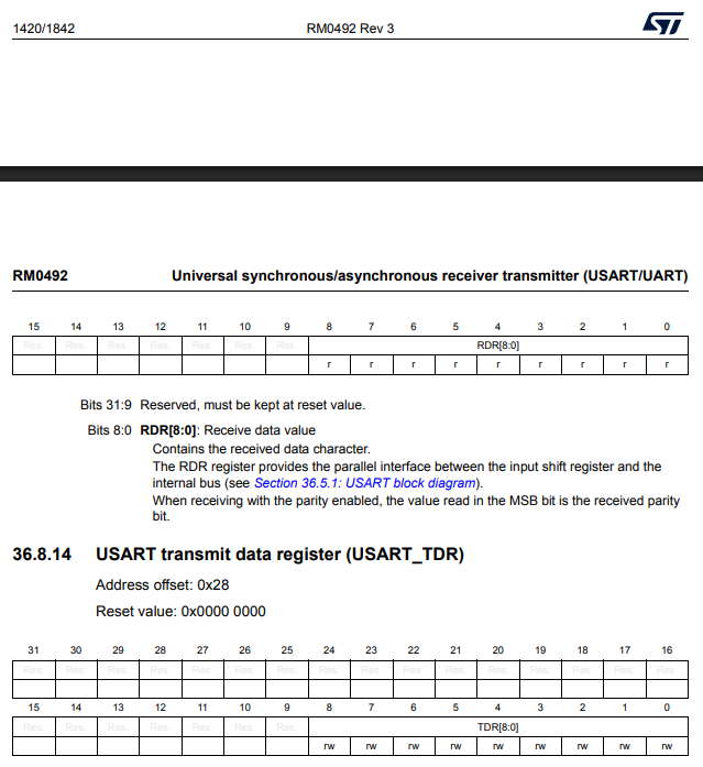

@Bob S wrote:
if you want to send 1 byte you need to write 1 byte, not a 32-bit value
Well, the USART TDR register is a 32-bit register:
https://www.st.com/resource/en/reference_manual/rm0492-stm32h503-line-armbased-32bit-mcus-stmicroelectronics.pdf#page=1421
Right-o, I was thinking of the SPI data registers, that can take 8/16/32 bit writes.
