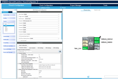

I have a breakout board, I've been testing some ws2812 code , I'm using  TIM1 with DMA + PWM
I developed the code on the G030, it's a 32 pin package.
I'm using internal clock and have it running at 48MHz for Timers.
Works has intended.
Switch to C011 in an 8 Pin package.
Created new project in MX and just copied over the code I added.
Code does not work.  complies fine, but the leds not work.
In both porjects I am using TIM1 , configured the same way.
I don't have a Scope where I can view the PWM output
Question:  Does anyone of a any differences between how TIM1 works between both MCU? I looked through  AN5969   Migrating between STM32G0 and STM32C0 MCUs  and nothing jumped out.
Can I use CudeMonitor to review the PWM?
Any suggestions would be highly appreciated.
Regards, Stephen

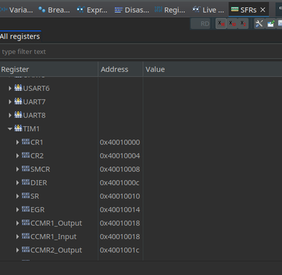

It should work...if compiler shows no warnings...?
to check, the tim/pwm setting: just stop it in debug and look at sfr -> tim1 , to see, whats it doing:

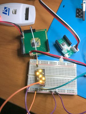

Bottom line, is I have made some 7 segment led displays 19mm x 12mm  using ws2812 leds

There shouldn't be a difference at the HAL level.
Are the pins properly configured?

This is my basic setup, I just swap the 2 break out boards, same leds , using a bench powersupply at 3.3 volts ,
I preformed all my original testing with the G030, with the C011 , I have only run basic led toggling code. before trying to move my code from G030 to it.
All done with the CubeIDE, just configured a new project for the C011
, Then used the IDE's compare file feature to code over my parts of the code from the G030 main.c, not using any libraries or extra .h .c files.....
Hmmm, maybe I should double check I have  selected the right C011?  apart from Flash sizes, is there any difference in timer operations between submodels to the same main MCU type?
