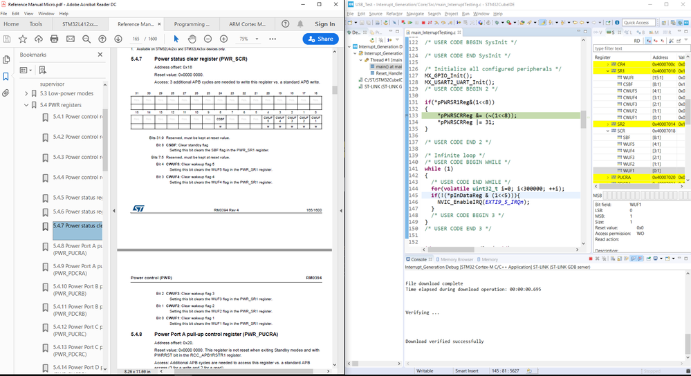

Software Bug I believe. Wrong register contents.
‎2020-06-18 10:23 AM

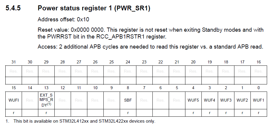

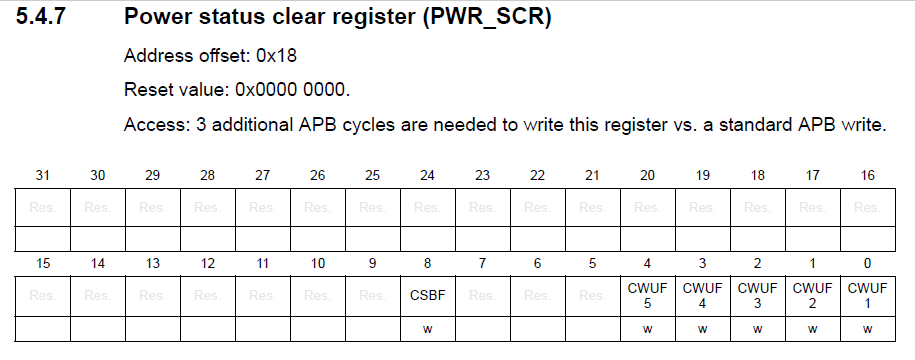

I am using Nucleo - L412KB I think I might have encountered a Software bug. As you can see in the screenshot, the contents of the PWR_SCR in the SW don't match with the one in the reference manual. The contents of this register are probably swapped with PWR_SCR register and some bits are missing too.
PWR_SCR: Power Status Clear Register
PWR_SR1: Power Status Register
Solved! Go to Solution.

‎2020-06-20 12:06 AM
The bit naming in SVD file is wrong and ETX_SMPS_RDY bit is missing.

‎2020-06-28 5:21 PM
@Piranha​ @HPham.1590​ I am able to successfully do what I have to. It's just the naming. The naming is wrong and yes, I haven't checked the ETX_SMPS_RDY but, I am sure it works too. Just follow the datasheet, ignore what it says in the Software and you will be able to get your desired outcome.
Thanks guys for your answers:)
‎2020-07-15 9:52 AM
Hi @Anonymous​ ,
I reported this error found on STM32L412.svd (and STM32L4x2.svd file) internally.
Thanks for highlighting it and I will keep you informed once fixed.
