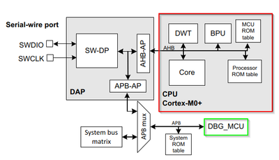

The DBG debug block diagram on page 1246:
To me it looks like the used terms are not detailled enough or mixed. And the statement from #2 above is outdated.
So, just to be sure that I understand it correctly: The part marked red corresponds to the CPU debug port from #1 & #3 and is disabled on RDP2, the green one is the debug interface from #4 above and still (always?) enabled, therefore it allows the regression by the OEM keys? Also, the green one is not available on devices without regression feature, right?

The DBG_SWEN is not really useful when using RDP2 because debug interface is disabled anyway.
The only thing you can do in RDP2 is to shift bits on the debug interface in reset. The debug IP of the code is disabled.

Hello @Jocelyn RICARD
okay, so I really need to differentiate the terms - that's why I was confused from the statements of the documentation:
So, debug interface disabled simply means it's not possible to debug. But the SWD interface is still open, allowing to use the OEM keys to re-open the debug interface, right?
