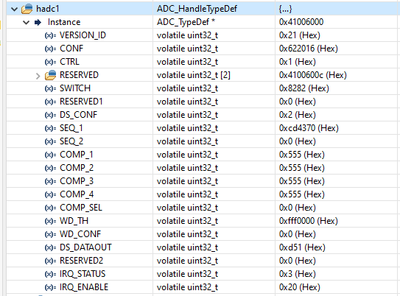

ADC register settings:
Finally, note that COMP_x registers are at default values.
And indeed, I didn't find any documentation about estimating COMP fields: OFFSET and GAIN;
it would be possible having a GND and VREF input capability, which I didn't find, either.

a) Conversion is done based on VREF+. It's a custom board, so you'll have to set this up correctly if you want a particular voltage.
b) Increase your sampling time to max. There is a minimum sampling duration on the temperature sensor which can be found in the datasheet.
Edit: Oh, the ADC on here is completely different from other STM32 chips. Sorry for the noise. Possibly still something to the second point.
