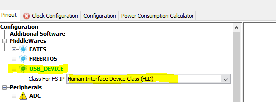

0693W000001srSUQAY.pngJust i could not do this , How can i do this with assembly language ?
