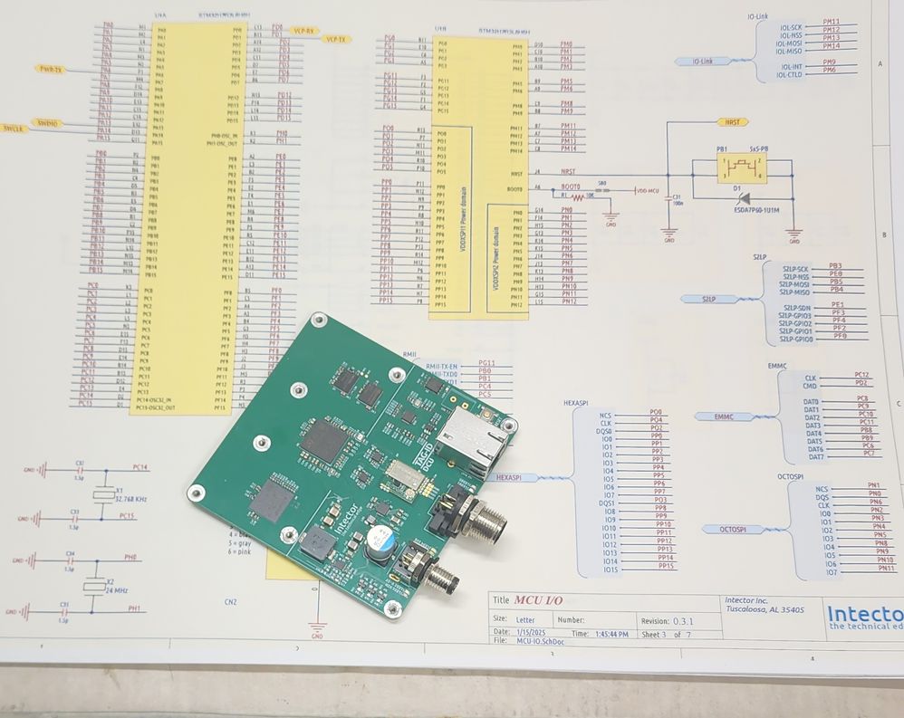

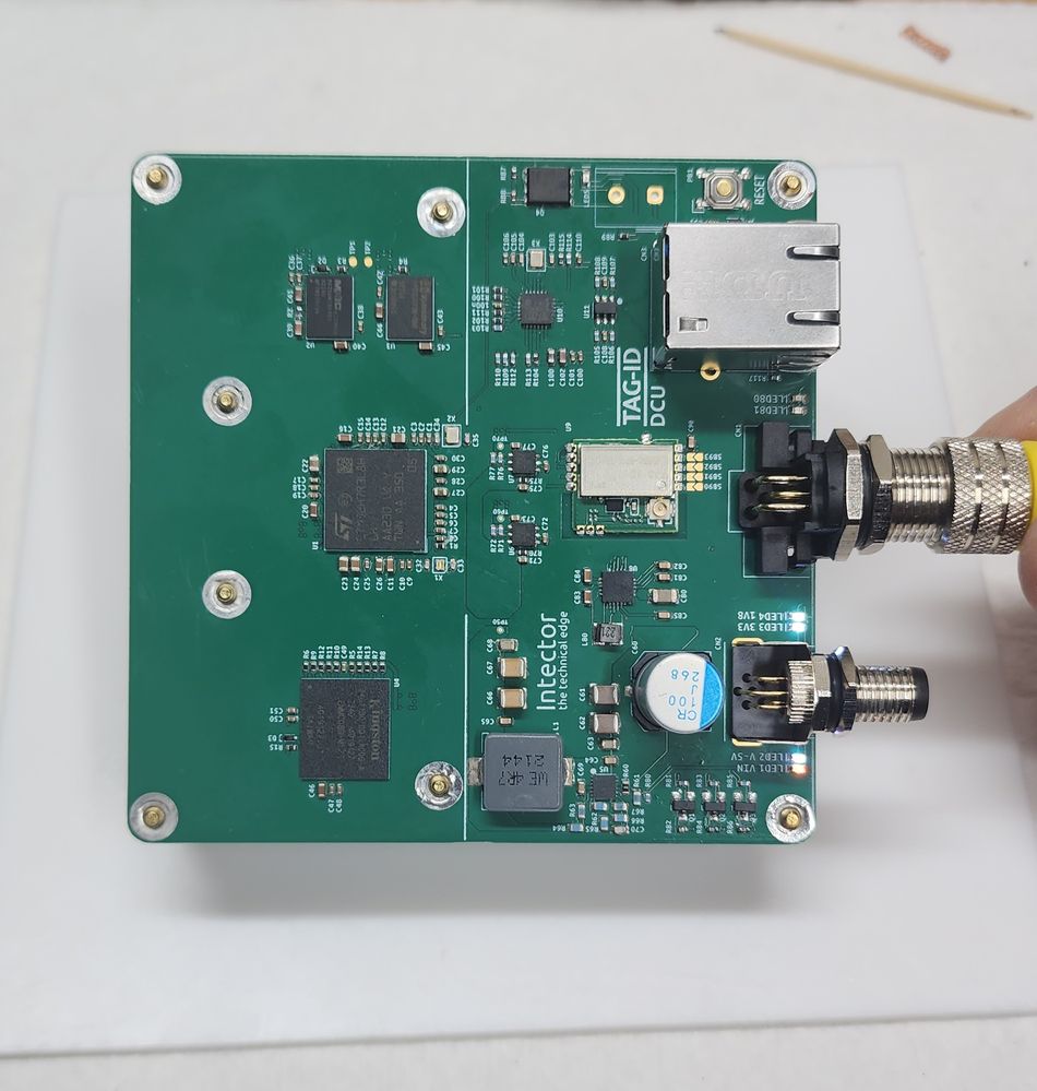

I'm working on a project for which I designed a custom board. It consists of the following components.
Arm® Cortex®-M7 32-bit 600 MHz MCU, 64 KB flash, 620 KB RAM, Ethernet, 2x USB, 2x FD-CAN, advanced graphics, 2x12-bit ADCs
1.8V 256M-BIT [x 1/x 8] Read-While-Write Octal SPI Memory
1.8V 256M-BIT Double-Data-Rate Octal SPI PSRAM with x8/x16 interface
8G-BYTE eMMC chip
MII/RMII 10/100 Ethernet Transceiver with HP Auto-MDIX and flexPWR® Technology
dual channel transceiver IC for SIO and IO-Link sensor applications
RC-SPIRIT2-915 module based on STMicroelectronics S2-LP transceiver
Here are some pictures of the board:
