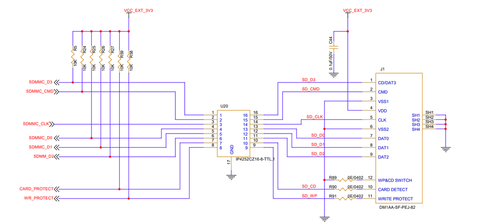

Hi
i am using STM32H753z, now i am trying to access SD card  but i getting  some error in stm32h7xx_hal_sd.c file of static uint32_t SD_PowerON(SD_HandleTypeDef *hsd)  API,s  in this
/* SEND CMD55 APP_CMD with RCA as 0 */
errorstate = SDMMC_CmdAppCommand(hsd->Instance, 0); (errorstate is 4(return))
if (errorstate != HAL_SD_ERROR_NONE)
return HAL_SD_ERROR_UNSUPPORTED_FEATURE;
it return in HAL_SD_ERROR_UNSUPPORTED_FEATURE is any region to this, if i need to use old SD card is process?

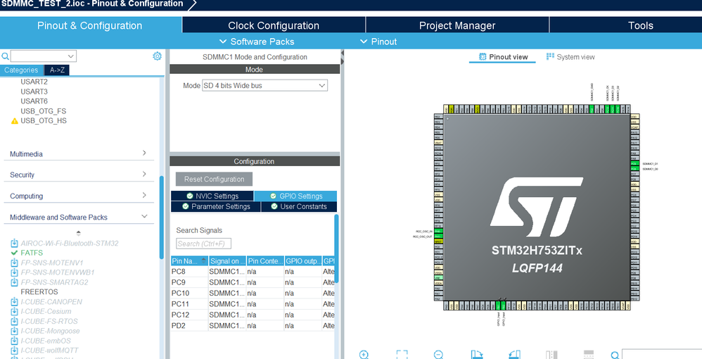

Naresh_
Hi SHs,
          i am using 3.3V with pull up register 10kohm.
I.KHACHINE
Hi Naresh_,
If you are using an ST Board, try to run the examples provided in the package.
If you have your own board, pls check the connection between the MCU and your uSD card connector and make sure you are configuring correctly your pinout using CubeMX.
Best Regards,
Ismail

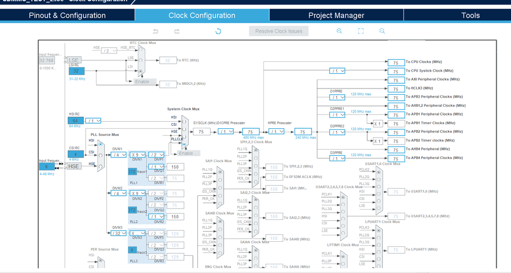

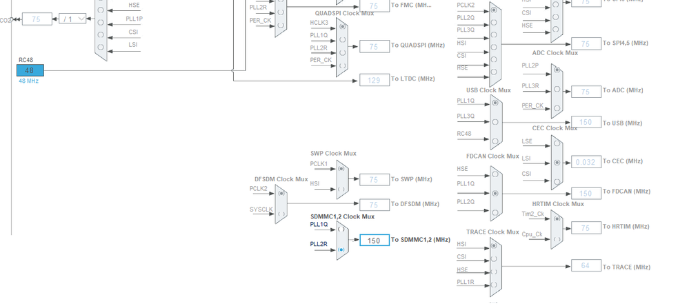

Hi Naresh,
Your setting should be ok. I understand that you are using your own board ( not ST board).
Could you plot the signal SD_CLK and SDMMC_CLK, just after the fail?
Second point, what do you mean by old SD card?
FYI, the driver support all uSD cards with capacity not exceeding 32GB.
Best Regards,
Ismail

Hi Khachine,
 SDMMC is working (write, read) in debug mode but same this not working in normal mode.
Regards,
Naresh
